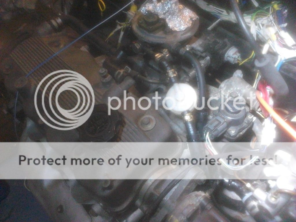

Ok so it was not the right ECU
the guy selling it neglected to tell me it was from a G10A Rather than as I had asked from a G13BA. I guess its back on ebay for that then

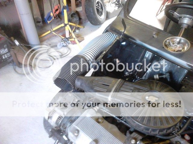

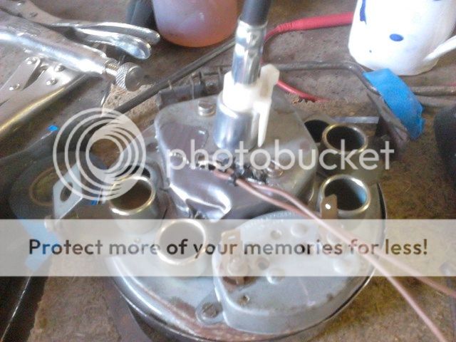

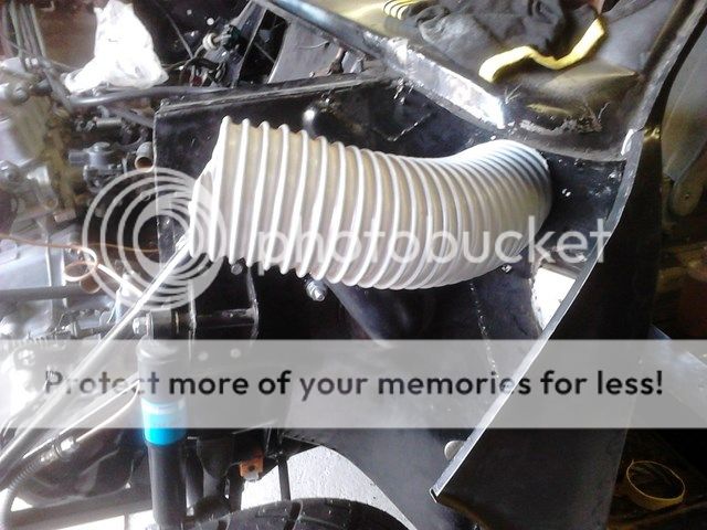

I made the speedo so the swifts cable would attach to it...
and fitted a load of ducting for providing fresh air to the vents, heater and air box/filter...
I will need to fit some other ducts to the flip front at a later point.

So that's where to hose of my tumble dryer went!!!
Coming along nicely mate..keep up the good work

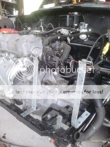

So the ECU saga go's on and I don't even want to talk about it

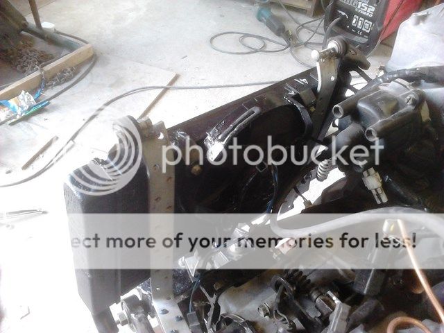

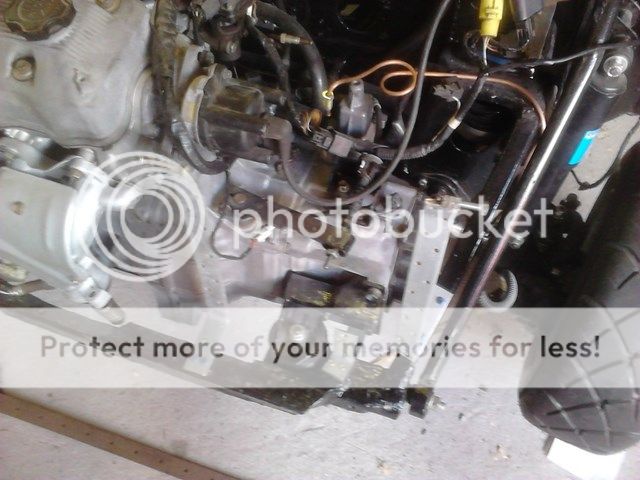

So while i'v been waiting for that and brakes to sort themselves out I have not been doing much but today I was back on it and today was fitting the radiator, and it all went rather well I think. I started by making up a bracket to hold one side of the rad by its existing rubber mounting point...
I then held the rad using this so as to fit the front and decide where and how else to fix it, and check the fit...
Having established it would fit and where it was going to need to be held I made up a couple more brackets and fitted it all on....
I am confident there is space enough for me to plumb it all in so I reckon its a winner

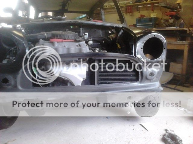

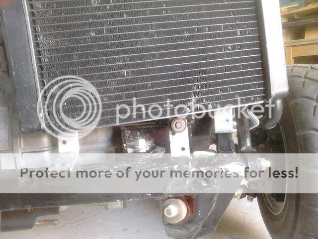

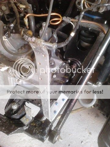

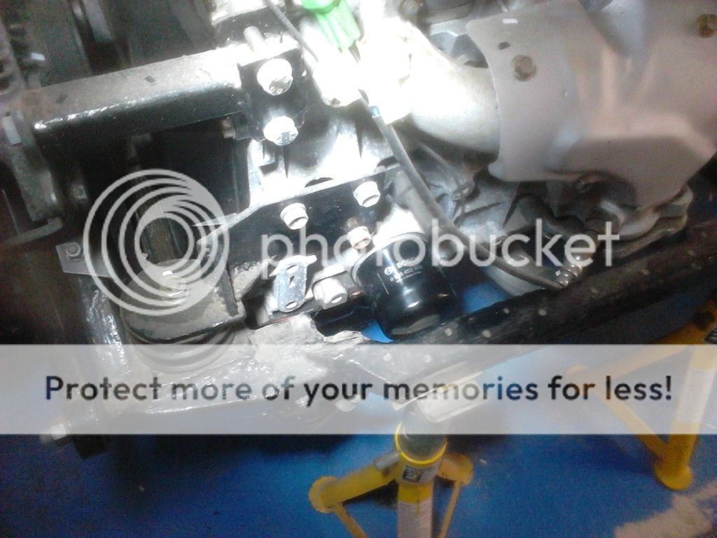

With the rad in place I decided to have a look at its hoses today and what I was going to need to do to finish off the cooling system. I started by seeing ho much I could put together using the bits of hose I had kicking around, and after some messing around the answer it seemed was all of it so all i need to get hold of is 5 or 6 more spring clips and the system is water tight (baring the inevitable leaks that will need sorting)
As you can see I am seriously starting to run out of space lol I am fairly sure there is space enough for the master cylinder to go back in.

In the end I needed an ECU with its immobliser unit, and the immobliser needed the key, and the key needed the ignition barrel to read it!
All of this I was eventually able to find on German ebay at a not inconsiderable price but there was not really any other way around it, without the electronics box the engine was scrap metal!
I had not been boring you guys to much with all the details of that saga but if anyone is interested I was keeping a diary of that on here http://rhinopower.activeboard.com/t5344 ... ject/?a=53
As you can see the main man "Rhinoman" has been as helpful as he can but in the end as I knew what I needed now, buying it in was the only sensible way to sort it. Wiring the whole bloody lot into the car is another game all together and I am more than a little apprehensive of that I can tell you.

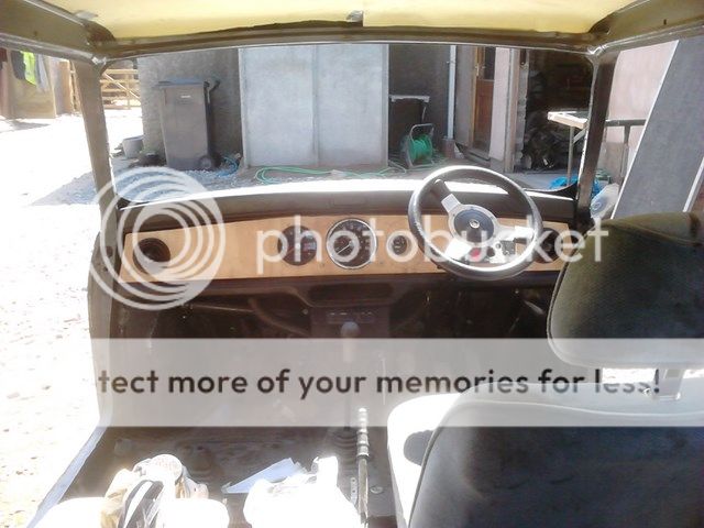

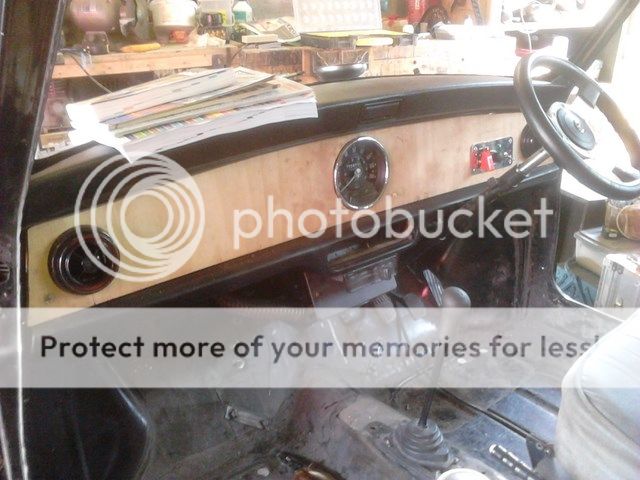

I did actually spend some time on the car this morning. I am endeavoring to fabricate a mock-up dash in order to establish fixing points etc. I rediscovered some of the interior trim bits and intend to make a dash and use them in a way like this...
I don't know how it is that others fix the dash in but I have made up some mounting brackets today and am happy they will do the job. More on that as and when it happens

LOL No sorry I wasn't clear, that is sort of how I will want my dash to look! That is actually just a pic I found on the net. The temporary dash I have made looks nothing like that but the dash rails in the picture are the same as the ones I have.

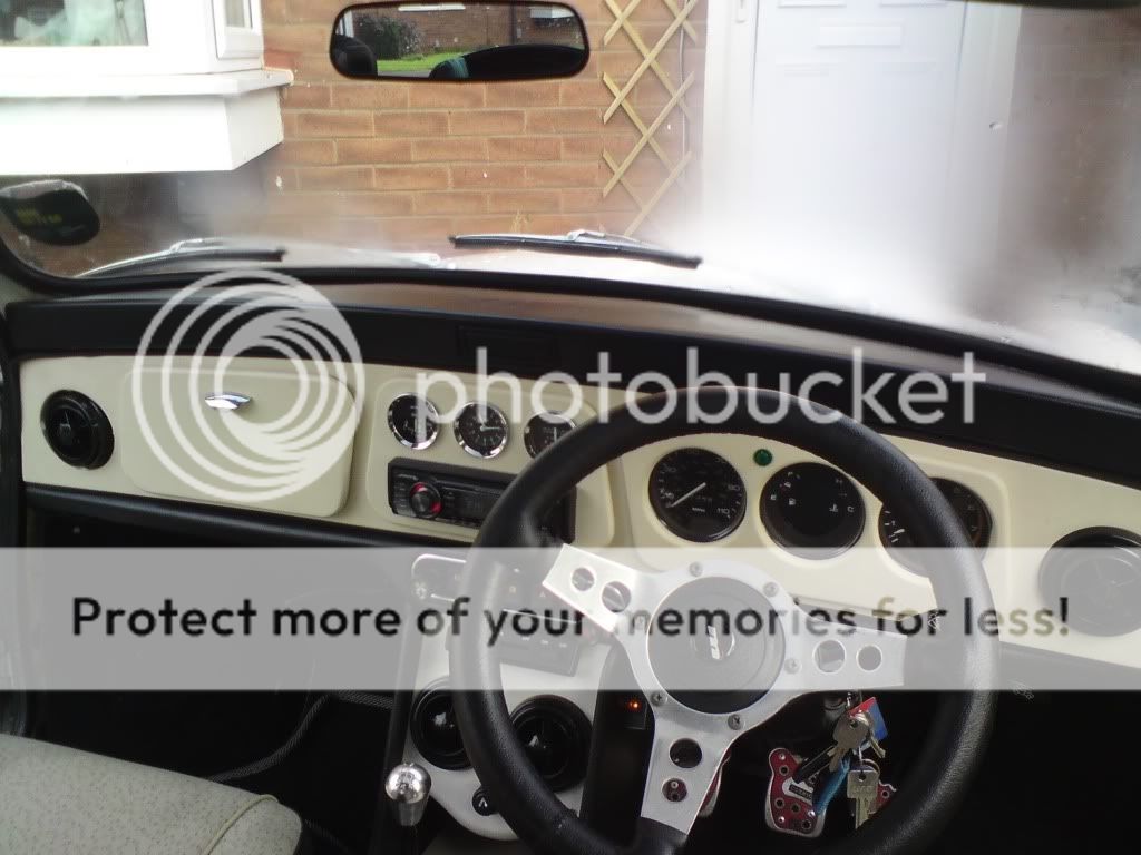

Having established some mounting points (easier said than done) I am now able to mount my mock dash with the speedo, vents and starting panel.
Bearing in mind that this is only a temporary practice one I think it is going to look good, I still need to fit the rev counter and temp gauge. Then I need to decide what else (if anything) I want on/in it? Then make a nice finished one
Also I buying a house and so with a bit of luck I will be moving the project into this rather nice looking garage

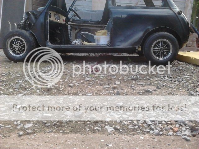

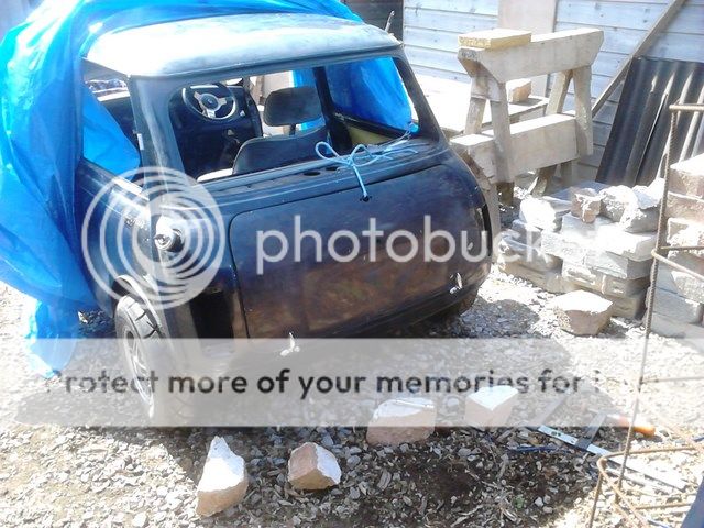

I have now been evicted from my dads garage as he needs it for some work he is doing. This gave me the push to sort out one or two things, namely removing the "crate on casters" from the bottom of the car and for the first time sitting it on its own 4 wheels That done I did a few very rough front suspension adjustments in order that it wasn't sat on the bump stops and the wheels pointed in approximately the same direction.
I have also checked that the boot still fits...
With the car outside again for now I invested in a new tarp to wrap it all up in (not that there is to much rain right now!) I have been very happy to see the car looking and being a lot more like a car again, it even rolled out of the garage to its new resting place on its wheels!! I steered it and everything
Seeing it in the sun with its fantastic wheels on and everything really made my day, it is going to be great when its all done (even if I say so myself). All I need to do is sort that god dam wiring and the rest is plain sailing i'm sure.

I have done a little more messing around with the dash and decided on the instruments/gauges and there position. In the end I went for a rev counter and mounted that to the left of the center speedo. I thought about having it on the right directly in front of the driver but decided I could then see it less (because of the steering wheel) than if it was further away. The setup inside the mini is so small that it is easy to see the rev counter despite it being on the other side of the car! Other than that I have gone for a coolant temp gauge, a smiths one, that will be interesting to make read right with the suzuki sender .
I am toying with the idea of a stereo in the space on the left but am not yet sure, may even go for the retro cool of a CB radio not that there would ever be anyone worth talking to on it but it gives you a reason to have a huge aerial on top of your car

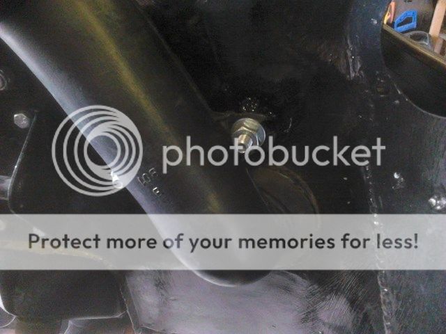

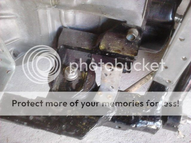

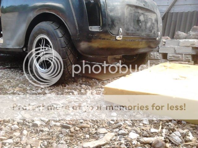

Something I decided to do today is try the exhaust on for size now that the car is on its wheels! It was a bit of a game getting it to fit on working alone but I got there...
Considering the car is pretty much sat on its bump stops (due to me not yet adjusting the suspension at all) I think the clearance is quite good

well, well, you have been busy, you've made loads of progress, well done on all the problem solving.
at least now its on all 4 wheels i can recognise things its looks great so far
hope the house move goes smoothly (if there is such a thing as an easy house sale)

Hi again, Its time for a quick update I think. I have moved house and now have my own garage in which to work on the mini, thats the good news the bad news is that the moving stress has caused me to forget just about everything I was doing regarding the mini lol. Oh well when I get back into it I will be fine I hope.
The new work space is nice (even if the family do keep cluttering it up with junk!) and I have moved the car and most of the tools etc. over.
So its not exactly organised yet but it has potential
I don't know yet exactly when I will really be cracking back on with the car as there are a few tasks around the house that i'm led to believe are more important but I will be cracking back on some time soon I hope

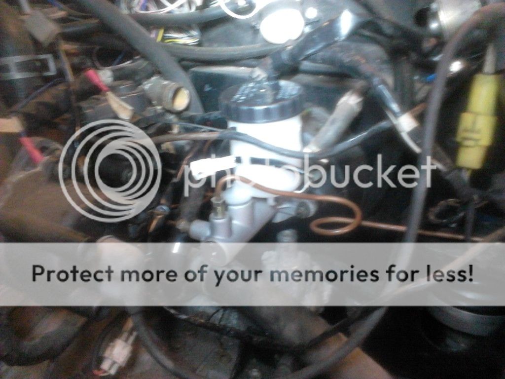

So I finally actually did something on the car again.....
First the tiny job of fitting a new oil filter (not the oil though)
then fitting a brand new master cylinder (after all the trouble with the other one I think it was knackered) but am yet to bleed it up and test it as it will need 2 people.
And then on to maybe the most daunting part of the build, the wiring. I have elected to custom build a new loom (for the engine electrics at least) and have now got as far as getting all the wire and stuff together and fitting the correct(ish) colored wires to the ecu connectors in the right locations......
now I just need to connect the other ends
I am fairly confident I have all the information I need to do that It is just a matter of taking it one wire at a time and making double sure I wire it to the right place, I have the internet, a load of PDF manuals and if I get totaly stuck I will try rhinoman at "RhinoPower forums" as he was very helpful in identifying the ecu for me in the first place.
A way to go still but it is nice to be working on it again!

Right well I have a few bits of progress to report, no. 1 the new petrol tank I got is now all sorted, by which I mean the minis fuel pump has been swapped for my origional swift petrol pump that I was able to reclaim from my previous effort.
So tank all sorted...
In the name of doing my fuel system properly I did decide to replace/upgrade the fuel lines as I was really not happy with the cheap ones I had...
I am much happier with these and as you can see I have doubled layered the parts of the hose that could potentially rub during operation.
I also decided that this would be a neat place to fit the fuel filter....
On top of that I have been starting to make some preparations for a test run of the engine soon, namely filling with engine oil. I have been warned that as the engine has been drained of oil, sat for some time and hasn't been run in years that I would really need to work some oil around the engine before starting it up. So this I did, I removed the spark plugs and hot wired the starter motor..... but aside from a few clicks nothing. After a little research into seized engines I chucked some WD40 into the pistons left it over night and then turned the engine over via the nut on the crankshaft pulley, it came loose easily but still the battery I had could not turn it over. Deciding the battery just didn't have the balls any more I swapped it for a different one and bingo it turned over a treat a few cycles of cranking till the battery is flat then charging and repeat should lubricate things up nicely inside the engine ready for firing up!
Lastly I have finally got round to sorting the brakes out and bleeding them up, I am pleased to report (at last) that they are (or appear to be at least) fine and operating correctly. They will of course as everything does need further attention and correct setting up and adjustment when I am able to test things fully and actually get it moving on a road, but once its running there will be a lot of readjustment and realignment needed.
